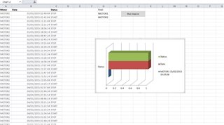

When I try the example as given on your page https://pt-br.infragistics.com/products/ignite-ui-react/react/components/spreadsheet-overview
with an excel with charts. the output ui is not able to render the chart but I just see chart data.
My particular requirement is to create a read only excel viewer on my react web page that should render excel files as is (i.e. along with charts graphs images and all) .

Hello and thank you for following up.
3d Charts are not supported chart types. Please submit and new product idea.
I changed your chart type to a normal cluster bar and it's not loading in the spreadsheet. I logged a development issue and opened a support ticket for you. C-00222016

Hi Michael
Apologies, Its a Typo. I am referring to a blank spot / area in the middle of screen .
PFA screenshot
Ideally a colored chart must appear in the blank area like below.

Can you point out the black spot artifact you are mentioning? I cannot tell from your screenshots. Preferably, please modify the sample I linked above and attach it.

I have observed an issue with rendering charts on .xls files.
As you can see in the screenshot I am getting a black spot in the middle of excel.
Also adding the code.
import React from 'react'; import ReactDOM from 'react-dom'; import './index.css'; import { ExcelUtility } from './ExcelUtility'; import { IgrExcelXlsxModule } from 'igniteui-react-excel'; import { IgrExcelCoreModule } from 'igniteui-react-excel'; import { IgrExcelModule } from 'igniteui-react-excel'; import { IgrSpreadsheetModule } from 'igniteui-react-spreadsheet'; import { IgrSpreadsheet } from 'igniteui-react-spreadsheet'; import { IgrSpreadsheetChartAdapterModule } from 'igniteui-react-spreadsheet-chart-adapter'; import { SpreadsheetChartAdapter } from 'igniteui-react-spreadsheet-chart-adapter'; import { Worksheet } from 'igniteui-react-excel'; import { WorksheetCell } from 'igniteui-react-excel'; import { ChartType, ChartTitle, FormattedString } from 'igniteui-react-excel'; IgrExcelCoreModule.register(); IgrExcelModule.register(); IgrExcelXlsxModule.register(); IgrSpreadsheetModule.register(); IgrSpreadsheetChartAdapterModule.register(); export default class SpreadsheetAdapterForCharts extends React.Component { public spreadsheet: IgrSpreadsheet; constructor(props: any) { super(props); this.onSpreadsheetRef = this.onSpreadsheetRef.bind(this); } public render(): JSX.Element { return ( <div className="container sample"> <div className="options horizontal"> <input type="file" onChange={(e) => this.openFile(e.target.files as FileList)} accept=".xls, .xlt, .xlsx, .xlsm, .xltm, .xltx"/> </div> <IgrSpreadsheet ref={this.onSpreadsheetRef} height="calc(100% - 30px)" width="100%" /> </div> ); } public openFile(selectorFiles: FileList) { if (selectorFiles != null && selectorFiles.length > 0) { ExcelUtility.load(selectorFiles[0]).then((w) => { this.spreadsheet.workbook = w; }, (e) => { console.error("Workbook Load Error"); }); } } public onSpreadsheetRef(spreadsheet: IgrSpreadsheet) { if (!spreadsheet) { return; } this.spreadsheet = spreadsheet; this.spreadsheet.chartAdapter = new SpreadsheetChartAdapter(); const url = "https://static.infragistics.com/xplatform/excel/SalesData.xlsx" ExcelUtility.loadFromUrl(url).then((w) => { this.spreadsheet.workbook = w; }); } /* public onSpreadsheetRef(spreadsheet: IgrSpreadsheet) { if (spreadsheet) { this.spreadsheet = spreadsheet; this.spreadsheet.chartAdapter = new SpreadsheetChartAdapter(); const url = "https://static.infragistics.com/xplatform/excel/ChartData.xlsx"; // ExcelUtility.loadFromUrl(url); ExcelUtility.loadFromUrl(url).then((w) => { this.spreadsheet.workbook = w; const sheet: Worksheet = this.spreadsheet.workbook.worksheets(0); sheet.defaultColumnWidth = 450 * 20; sheet.rows(0).height = 150 * 20; const cell1: WorksheetCell = sheet.getCell("A1"); const cell2: WorksheetCell = sheet.getCell("B1"); const cell3: WorksheetCell = sheet.getCell("C1"); const cell4: WorksheetCell = sheet.getCell("D1"); const dataCellAddress = "A3:D6"; const title: ChartTitle = new ChartTitle(); title.text = new FormattedString("Line Chart"); const chart1 = sheet.shapes().addChart(ChartType.Line, cell1, { x: 5, y: 5 }, cell1, { x: 90, y: 90 }); chart1.chartTitle = title; chart1.setSourceData(dataCellAddress, true); const title2: ChartTitle = new ChartTitle(); title2.text = new FormattedString("Column Chart"); const chart2 = sheet.shapes().addChart(ChartType.ColumnClustered, cell2, { x: 5, y: 5 }, cell2, { x: 90, y: 90 }); chart2.chartTitle = title2; chart2.setSourceData(dataCellAddress, true); const title3: ChartTitle = new ChartTitle(); title3.text = new FormattedString("Area Chart"); const chart3 = sheet.shapes().addChart(ChartType.Area, cell3, { x: 5, y: 5 }, cell3, { x: 90, y: 90 }); chart3.chartTitle = title3; chart3.setSourceData(dataCellAddress, true); const title4: ChartTitle = new ChartTitle(); title4.text = new FormattedString("Pie Chart"); const chart4 = sheet.shapes().addChart(ChartType.Pie, cell4, { x: 5, y: 5 }, cell4, { x: 90, y: 90 }); chart4.chartTitle = title4; chart4.setSourceData(dataCellAddress, true); }); } }*/ } // rendering above class to the React DOM ReactDOM.render(<SpreadsheetAdapterForCharts />, document.getElementById('root'));
Actual file looks like this ->
Is it like this utility only supports .xlsx files?
