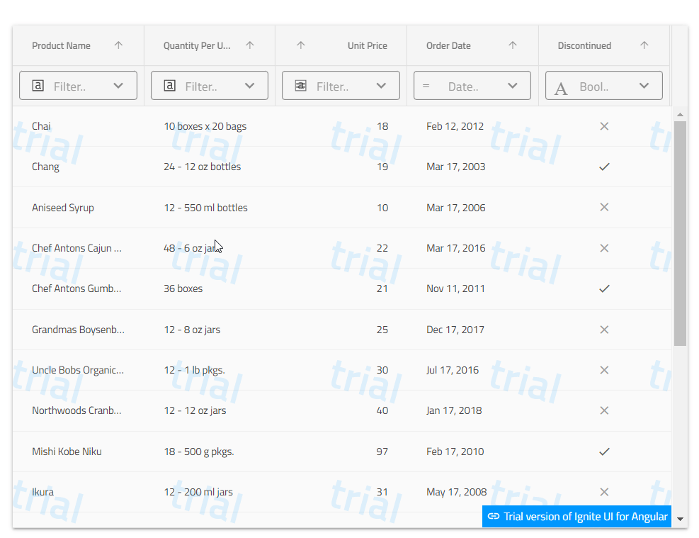

    Georgi Anastasov answered on Nov 30, 2022 10:20 AM
    Hello Roopesh,
    I have been looking into your question and the given requirements are fully present in the already defined filtering feature of the igx-grid component. You could take a look at the Quick Filtering mode, which provides an input field that expands a drop-down list with defined conditions for filtering the grid. You could also take a look at the Excel Style Filtering mode with additional options for filtering and selecting a value from the given column. Additionally, there is another filtering mode too, Advanced Filtering.
    However, in order to create your own custom filtering according to these requirements, you have to first enable grid filtering by setting the allowFiltering property to true and handle the filterCellTemplate property of the columns by providing a reference to your custom filtering.
    For this purpose, you will create an ng-template element that will have an igxFilterCellTemplate directive and will contain an igx-input-group component for this custom filtering. In the input group, to begin with, you will create an igx-prefix with an igx-icon in it, from where, when clicked, an igx-drop-down component will expand, which will contain the filtering conditions. This will be done with the igxToggleAction directive which will be passed a reference to the drop down.
              {{ condition }}
    Then you should add an input element with the igxInput directive where given values ​​will be entered and the grid will be filtered. For this purpose, the input event of the input element will be handled and when it is written in the input field during the execution of the event in the function, the filtering condition will be checked, and the grid will be filtered based on it. For this purpose, there are predefined filtering conditions created in the igniteui-angular package, but also additional custom ones could  be added.
    public onInput(input, column) {
            let operand = null;
            if(this.dropdown.selectedItem.index === 0){
                operand = IgxStringFilteringOperand.instance().condition('contains');
                this.grid1.filter(column.field, input.value, operand, column.filteringIgnoreCase);
    Finally, in the template you will add an igx-suffix that will contain the icon for clearing the input field when there is an entered value in it. You'll also add another igx-suffix that will contain the arrow icon to expand the igx-drop-down component again passing a reference to the igxToggleAction directive that will contain the values ​​from the select column along with additional custom values for your custom logic. The selectionChanging event will be handled on the given dropdown and when a given value is selected from the column, the grid will be filtered by it.
              clear
    igx-icon>expand_more
    The described scenario could be observed here:
    In addition, I have prepared small sample illustrating this behavior which could be found here. According to your requirements, I have templated one column to represent this approach from string datatype, and additionally the other columns can be templated from different datatypes, more and new filter conditions can be added, etc. Please test it on your side and let me know how it behaves.
    Additional information about the filtering feature and igx-grid filtering mods could be found in this topic from the Angular documentation.
    If you require any further assistance on the matter, please let me know.

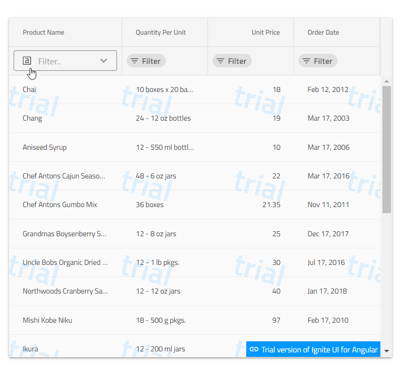

        Roopesh p m answered on Dec 1, 2022 8:49 AM
        I have implemented the changes as suggested by you. It looks great. When I try to implement those changes into more than one column and try to select or search from any of the dropdown it will also select same values from  all of other dropdown columns also.
        Here I have attached the screen shot
        Here I have selected search option "Start With" from first column, But Same time second column also auto selected with first column search selection
        Can you please hlep me to resolve this
        Georgi Anastasov answered on Dec 1, 2022 12:50 PM
        Hello Roopesh,
        After further investigation what I could say is that this is expected behavior since you are most likely using the same template for the next column and it is due to the two-way data binding of the input field itself. The two-way data binding on the input field is used because of the requirement to select a specific value from the given column.
        Precisely because of the specific requirements for creating custom filtering and selecting a value from the given column, different condition based on each column data type, as well as changing icons for each field, in this case separate custom filterings must be created for each column.
        What I could suggest you is to create a separate custom filtering template in the same way with an ng-template tag and its own reference, which contains an input group, also with the input field with different two-way data binding as well as igx-prefixes and igx-suffixes for the igx-icons which toggles the different drop-downs. As each custom filtering will use a different dropdown for the conditions according to the datatype of the column and a different dropdown to select the different values ​​of each different column. Both column dropdowns will again handle the selectionChanging event as before, but will perform a different function depending on the column.
        I have modified my previous sample and what I did is to add a separate custom filtering template for the next string type column as well as a custom filtering template for the number type column for your further reference and understanding, the filtering templates are identical and only the icons, conditions and functions that are executed when the events fire are changed.
        Here you could find the sample which illustrate this scenario. Please test it on your side and let me know how it behaves.
        I hope this has cleared up custom filtering templates and you could build your own. If you need more information about Ignite Ui Angular filter mods and filtering templates, you can find them on this topic.

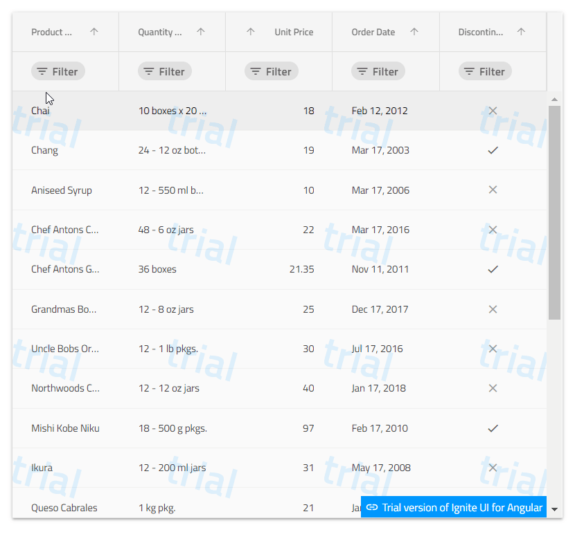

        Georgi Anastasov answered on Dec 1, 2022 3:07 PM
        Hello Roopesh,
        Regarding the new requirement for dynamic columns, in this case what I could advise you is to set static columns as in the sample provided by me, so that you can better manage the properties of each column separately according to the custom logic as it currently is the case of the filterCellTemplate property of igx-column components.
        However, what I could suggest you as an additional approach is to simulate something similar in order to implement the requirement with a custom filtering template, as in your div element with the *ngFor directive you will place one ng-container element to check the column by field and after this will generate a column with the filterCellTemplate property of the column template specifically set.
        In addition, I have modified my previous sample illustrating this approach which could be found here. Please test it on your side and let me know how it behaves.
        Thank you for your cooperation.

        Georgi Anastasov answered on Dec 5, 2022 8:36 AM
        Hello Roopesh,
        Thank you for following up, for the additional information and the screenshots provided.
        After further investigation, in fact, as you already understood from our correspondence, the templating of the given columns according to the initially set requirements is completely feasible with the igxFilterCellTemplate directive, on the other hand, however, your application and the custom logic that you have defined with the dynamic columns require the writing of many separate filtering templates for each column, which you said you were avoiding as a possibility.
        After the new requirements are simplified and each filter does not need to select a value from the column, but only a condition, with dynamic columns, this again leads us to create many custom templates with different drop-down conditions for each column.
        Аll this brings us to, the built in functionality of the igx-grid component – the quick filtering modе, best fits your description at the moment. It will provide the ability to select a condition, enter a value in an input field, select a date in a datatype column and all that is a maximum of 4 clicks as you expect.
        What you need to do is set the allowFiltering property of the grid to true.
        The described scenario with quick filtering and dynamic columns could be observed here:
        I have prepared small sample illustrating my suggestion which could be found here. Please test it on your side and let me know how it behaves.
